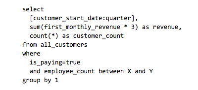

I had sought to answer a simple question, how much money are we making in this new segment over time? I needed revenue and customer count by quarter in this segment. The query looked like this:
This query gets me quarterly new revenue in this segment. Since our product is a subscription, revenue is recurring and making the chart cumulative over time is a simple matter of checking the "cumulative" checkbox in the chart editor.

Out of habit, I asked my data team to review my chart to make sure I hadn't made any major mistakes. I had made three mistakes in 9 short lines of SQL! Did you catch them? Quarterly revenue cannot be this complicated, right?
Here are the mistakes I made:
  • sum(first_monthly_revenue * 3): This gets me close to the quarterly revenue for each customer that quarter. However, it ignores plan upgrades or downgrades within the quarter. Likewise, using the "cumulative" checkbox assumes that customer is paying the same amount (their first month's amount) for every quarter they are a customer, and that isn't the case for most of our customers.
  • is_paying=true: This filters all_customers to those who are paying right now. This query is looking at the customers table "as it is", when I needed "as it was." The effect of this mistake is that I'm excluding historical revenue from all customers who have churned.
  • employee_count between X and Y: This is another case of "as it is" versus "as it was." We update the all_customers model regularly with fresh data, including their employee count on LinkedIn. The effect of this on my analysis is that I'm filtering to customers who are currently in this segment. That might be what I wanted, or I could have wanted quarterly customers who were in that segment, at that time. Or maybe customers should be filtered out once they grew out of the segment. Unlike the previous two issues which were clearly data mistakes, this issue represents an definitional ambiguity that could have had an unknown affect on the analysis.
My data team noticed these mistakes almost immediately (of course they did – they are amazing at their jobs) and provided me a corrected query in under an hour.

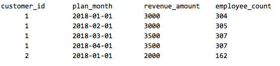

Here’s a look at the new all_customers_monthly model, so you can see how you might create models that prevent errors and enable answering similar questions in Periscope Data:

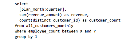

Which makes the revised query even simpler:
