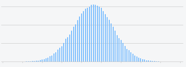

After an even distribution, your most basic distribution of random numbers is a normal distribution. In this post, we’ll show you how to use the Marsaglia Polar Method to convert random()’s uniform distribution into a normal distribution that looks like this:

To make a pretty graph of your distribution like the one above, combine the previous steps and then bucket and count the numbers (by rounding them) like so:

Now your randomly generated test data can look a lot more normal!
