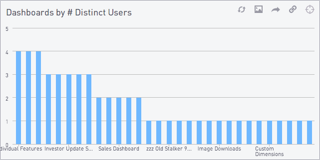

Let’s start with a simple query we run all the time: Which dashboards do most users visit?
  count(distinct time_on_site_logs.user_id)
from time_on_site_logs
join dashboards on time_on_site_logs.dashboard_id =
group by name
order by count desc
In Periscope, this would give you a graph like this:
