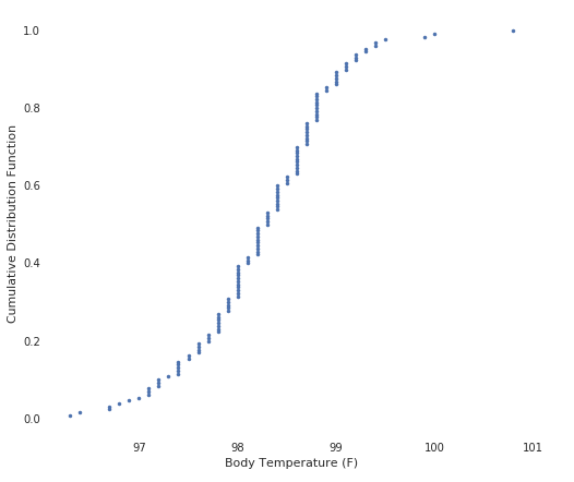

We can then use matplotlib and seaborn to plot our sample data with the following code:
plt.figure(figsize=(8,7))
sns.set()
plt.plot(x, y, marker=".", linestyle="none")
plt.xlabel("Body Temperature (F)")
plt.ylabel("Cumulative Distribution Function")
Running this will yield a chart that looks like the following:

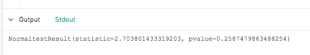

Let's add one more line of code to provide further insight into the distribution:
print(stats.normaltest(df["temperature"]))
Anything printed can be seen in the Stdout tab:
This will run SciPy's normal test and print the results including a p representing A 2-sided chi squared probability for the hypothesis test. If the p value is less than our alpha (significance value), we can reject the hypothesis that this sample data is normally distributed. If greater, we cannot reject the null hypothesis and must conclude the data is normally distributed.
