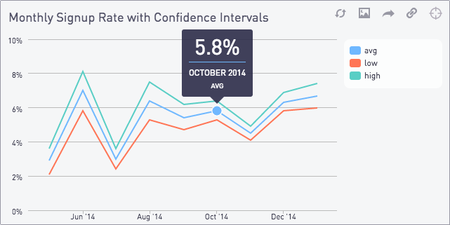

In Periscope, we can see those same results visually:
