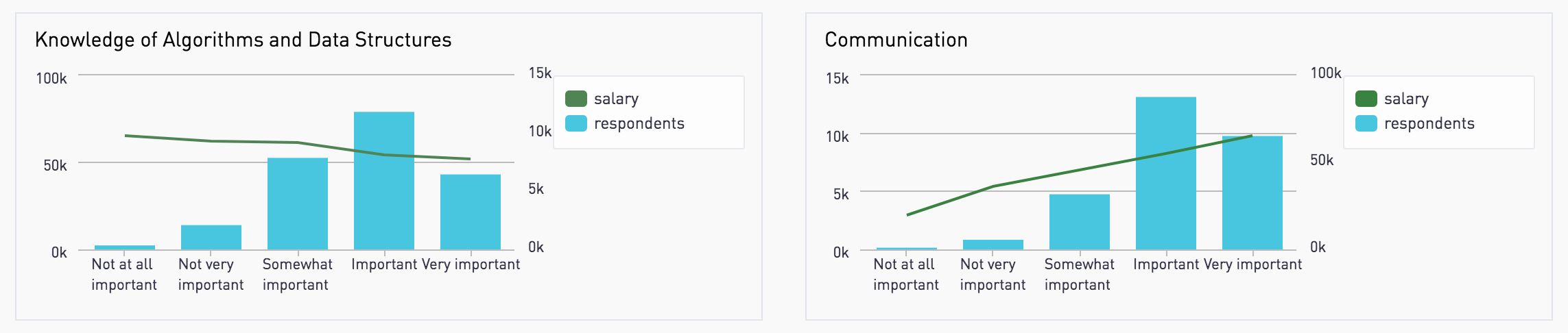

Let's make a few quick charts to celebrate. Stack Overflow asked a great series of questions asking people what attributes are the most important when making technical hires—including knowledge of algorithms, communications skills, titles and education.
We can compare a couple of those questions with the average salary of the respondents:
  importantHiringAlgorithms
  , avg(salary) as salary
  , count(*) as respondents
  stack_overflow_survey_data
group by
  1
order by
  1
And we quickly see that average respondent's salary actually decreases with a focus on data structures and algorithms when hiring! In contrast, a heavier emphasis on communications skills is associated with higher salaries.

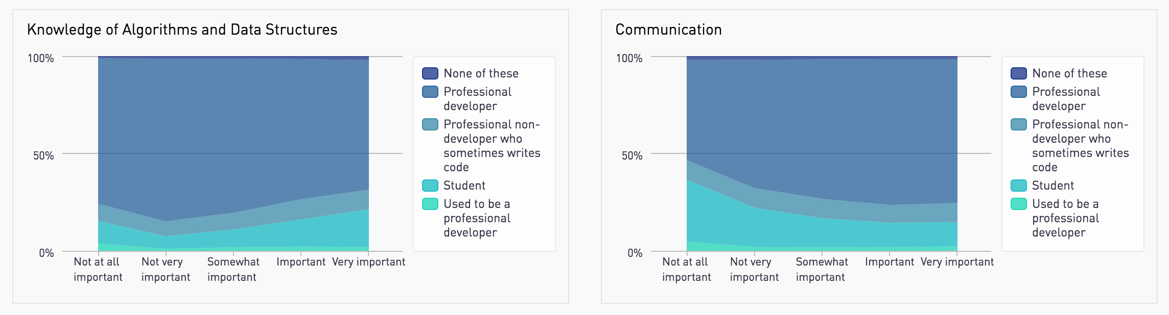

How important should each of the following be in the hiring process?
When we look a level deeper, we can see why—students aren't worried about communications skills yet.
While Stack Overflow didn't ask for respondent's titles, I suspect an emphasis on communication skills continues to grow as people advance their careers. It turns out communications skills are highly valued. Luckily, we've written a post about communications in analytics!
