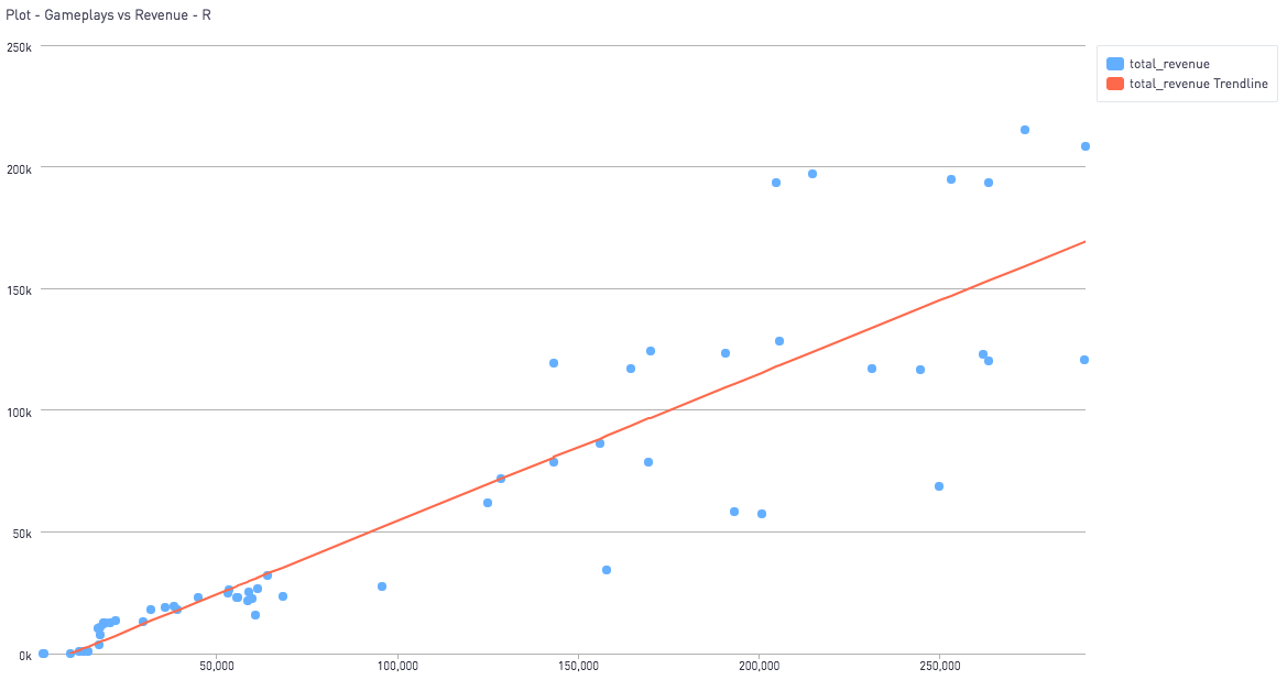

Equally important is knowing when not to use a linear regression. For example, the amount saved in a 401k vs. the annual return might fit more of a quadratic model, starting with a slow incline and becoming much steeper as the value of the account grows. A great way to start determining if a linear regression is appropriate is plotting your data with a scatter plot to look for visible trends. In Periscope Data, we can easily plot our data and draw a line of least squares by clicking the “Show Trendlines” box.
Looking at this dataset from a fictitious gaming company showing revenue vs. gameplays, we can see that there is clearly a positive relationship between the two variables that fits a linear equation and is probably worth exploring further.
