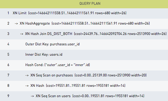

Using explain here produces the following query execution plan:
The steps in our plan are executed bottom to top. The first step is a scan and reading of all rows in the users table. The result is used to build a hash table, which will be used to join with purchases.
The purchases table is then read and joined to users, using the newly created hash table to look up the user_id field on the purchase record. The DS_DIST_BOTH indicates that both tables get distributed to various nodes for joining.
The HashAggregate builds a hash table to group by date and source. Finally, the limit would cut any rows in excess of 5000.
Each step comes with metadata attached — cost, rows and width. Cost is a relative value broken into two parts — startup cost, the cost to return the first row, and total cost, for the entire operation. Each step includes the cost of all steps below it. The cost is only useful for comparing inside a single query plan.
rows is the number of rows returned by the step. width is the average size of each row. If either estimate is badly off, run analyze on the table you’re querying and you may get a more efficient query plan.
When joining, there are four ways data might get distributed. In step 3 of our example above, DS_DIST_BOTH indicates that both tables must get distributed to all nodes. DS_DIST_INNER distributes the inner table to all nodes for processing, DST_BCAST_INNER broadcasts the entire inner table to all nodes, and DS_DIST_NONE indicates that all data is available for joining on each slice.
DS_DIST_NONE is generally the best option, unless there is a strong skew in the distribution of data and only a few nodes can work on the query. That can be determined by looking in svl_query_log.
