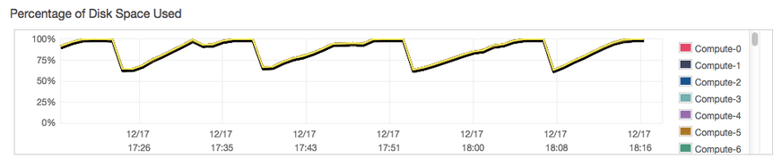

All of this is easy on small tables. vacuums are fast and changing keys is as easy as creating a new table and using select into to transfer the data.
But this doesn’t work on large tables. Either there simply isn’t enough extra space to duplicate the data, or the vacuum locks the table for far too long.
One Periscope customer recently came across this issue. They had an events table that was far too large to work with as a single table. So we broke it up into many smaller tables and wrapped them in a view.
