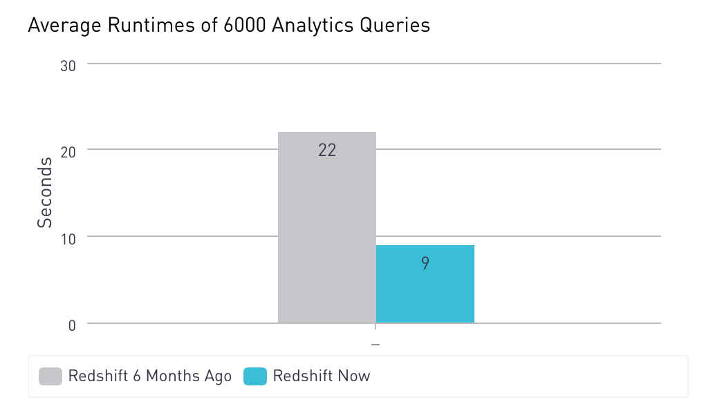

The current Redshift software performed significantly better than the older software — query times were more consistent and subject to fewer spikes (both in volume and magnitude) than the older software. If we look at the average query time for each cluster, we found this performance boost:
The set of queries run on the older software took an average of 22 seconds per query, whereas the same set of queries on the current software took an average of 9 seconds per query — equating to a 2.4x increase in average performance.

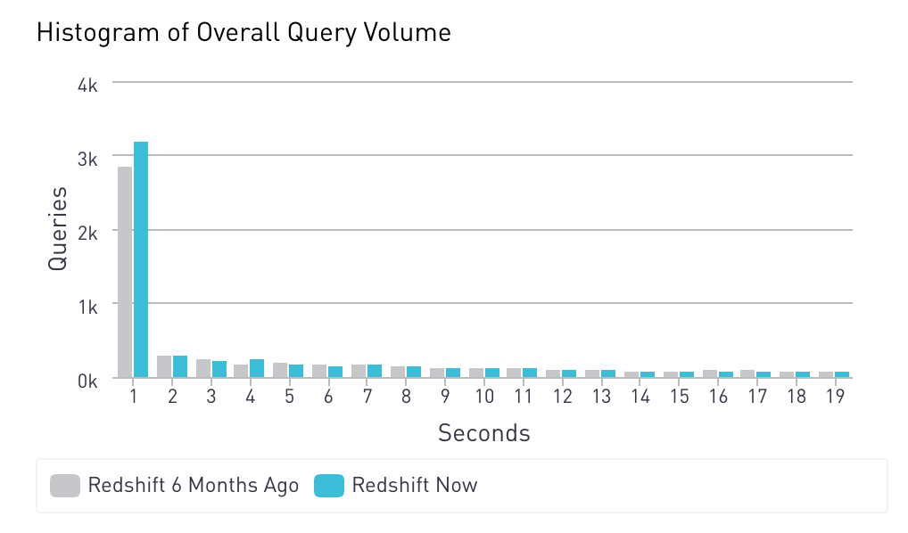

When we looked at the distribution of query times, we also noticed a higher volume of queries being returned sub-second on the current software than on the older software:

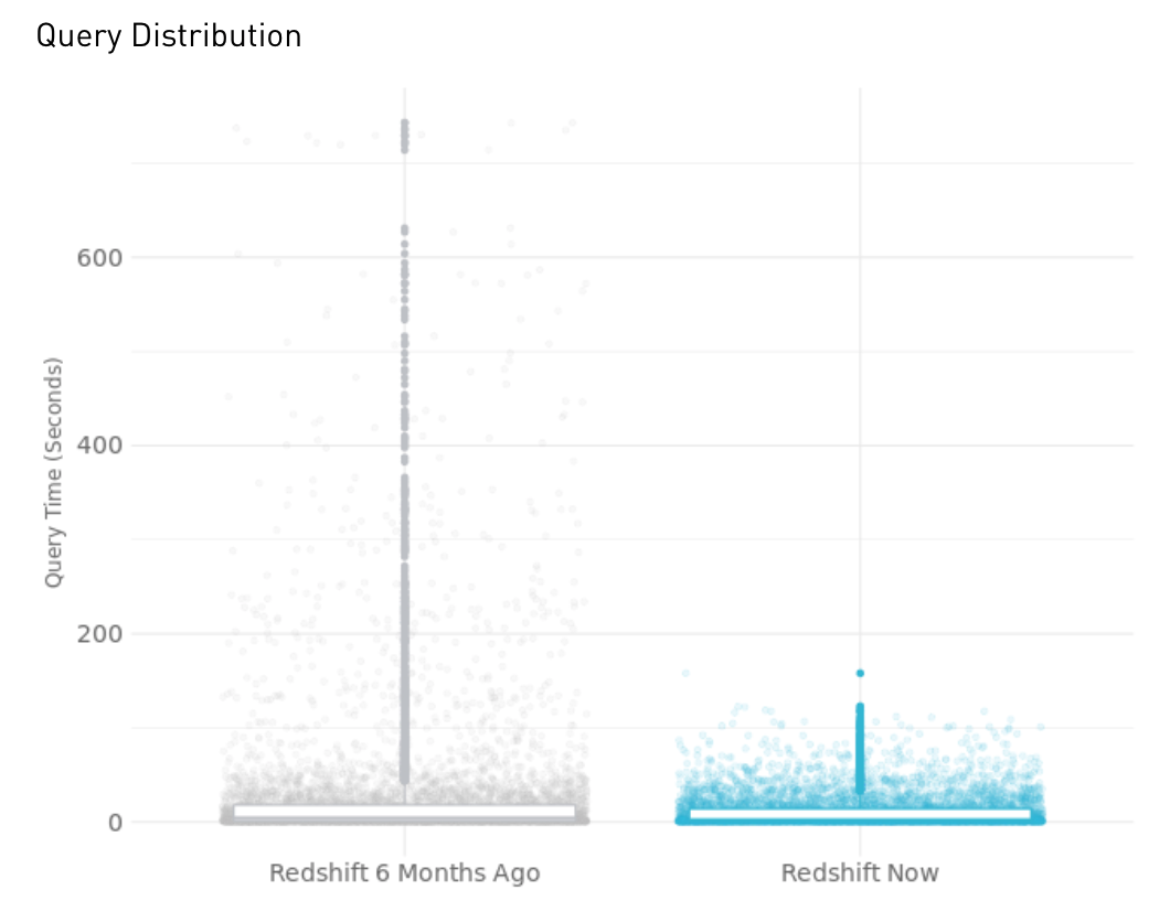

The current software also showed a tighter distribution of query times overall. To visualize this, we use a box plot which identifies the 25th, 50th and 75th percentiles of our query times as a box with any outlying query times denoted as points:

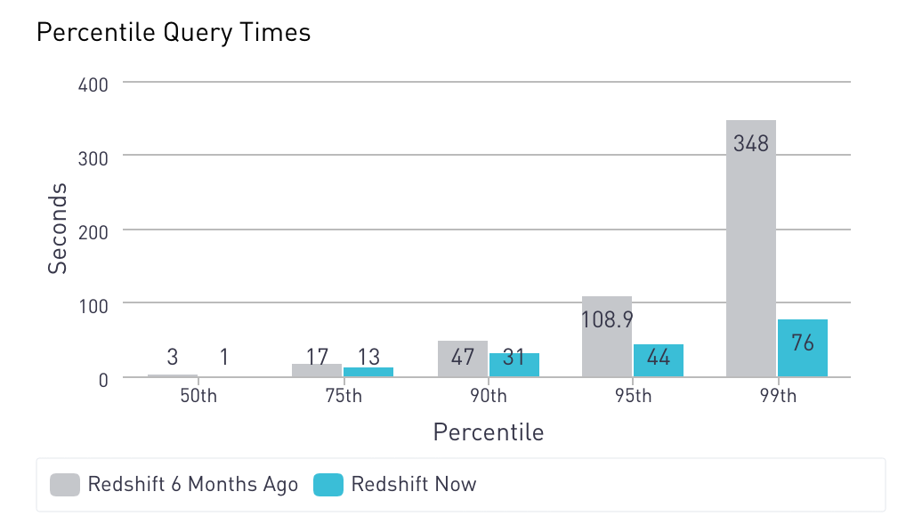

Even though the 25th, 50th and 75th percentile query times were about the same, the newer software experienced a significantly lower maximum query time than its older counterpart. We visualized the 50th, 75th, 90th, 95th and 99th percentiles to illustrate this difference:
This tells us that the top 5% longest-running queries experience improvements of 2.5x on the latest software — and queries in the top 1% nearly doubled that at 4.6x.
