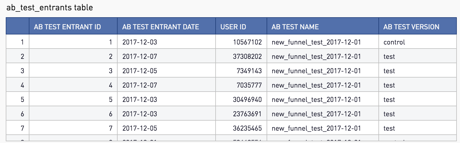

For this exercise, I’ve generated two tables of sample data, in a format you might expect to find it in a relational database. Check out my blog post on how to generate sample data in Excel and Google Sheets if you’re interested in more specifics. You can also check out the Google Sheet for A/B Test Sample Data here.
ab_test_entrants
This table contains the date a given user_id was entered into a test, the name of the test they entered into, and finally the version of the test they’re a member of. Tables like this should usually have a uniqueness constraint across user_id / test_name, so a business user knows that one user didn’t see multiple versions of a test. This particular sample table refers only to a single test, “new_funnel_test_2017–12–01”, but could theoretically contain more.

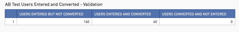

Check for orphaned users
With a FULL OUTER JOIN between the entrants and converting users, how many users fall into the three possible buckets: Entered but not converted, entered and converted, and converted but not entered?
 count(
   case
     when ab_test_entrants.user_id is not null
     and ab_test_conversions.user_id is null
       then 1
     else null
   end
 as users_entered_but_not_converted
 , count(
   case
     and ab_test_conversions.user_id is not null
       then 1
     else null
   end
 as users_entered_and_converted
 , count(
   case
     when ab_test_entrants.user_id is null
       then 1
     else null
   end
 as users_converted_and_not_entered
 [ab_test_entrants]
 full outer join [ab_test_conversions] using (user_id)
So far so good, 40 converted out of 200 total, with no orphaned converted users polluting my pool for analysis.

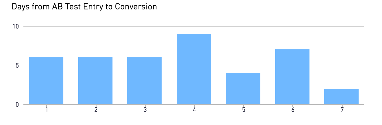

Check for conversions after test entries
With a LEFT JOIN starting from the AB test entrants, what is the distribution of days it takes to get from entry to conversion? Hopefully I see numbers greater than 0 to tell me I’m looking at the right time frame for conversion.
 datediff('day', date(ab_test_entrant_date), date(conversion_date)) as days_from_entry_to_conversion
 , count(*) as num_entrants
 [ab_test_entrants]
 left join [ab_test_conversions] using (user_id)
group by
 1
Also so far so good! Looks like this sample data set took at most 7 days to get from entry to conversion.

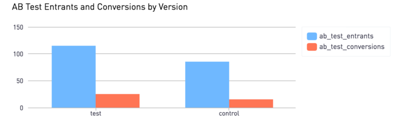

Check for data populating in each bucket
Finally, do I have the expected number of versions, collecting conversions in each bucket?
 ab_test_version
 , count(ab_test_entrants.user_id) as ab_test_entrants
 , count(ab_test_conversions.user_id) as ab_test_conversions
 [ab_test_entrants]
group by
 1
Yep! Two versions, both starting to collect real data to analyze.

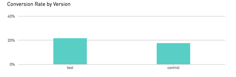

The simplest way to compare versions in an A/B test like this, is using conversion rates. So total number of unique users that converted in a bucket, divided by total number of users entered into that same bucket. From the above graph, the orange bar divided by the blue bar.
 ab_test_version
 , count(ab_test_conversions.user_id)::float /
   count(ab_test_entrants.user_id) as conversion_rate
 [ab_test_entrants]
group by
 1
Our test appears to be winning, 22% of users are converting vs. 18% in the control treatment! Now, how do we know if that’s a statistically significant result?

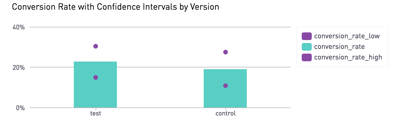

Calculating A/B Test Confidence Intervals in SQL
I’m going to crib heavily from Periscope Data’s great blog post on the topic, and estimate a confidence interval around the initial results using just SQL. In simple terms, the more data you have, the tighter the confidence interval, and the more you should believe that the 4 percentage point difference above is a real thing, not a statistical accident.
with
 ab_test_conversions as (
     ab_test_version
     [ab_test_entrants]
   group by
     1
 , ab_test_conversion_rates as (
     ab_test_version
     , ab_test_entrants
     , ab_test_conversions
     , (ab_test_conversions + 1.92) / (ab_test_entrants + 3.84 )::float as conversion_rate
     ab_test_conversions
 , conversion_rate_standard_error as (
     ab_test_version
     , ab_test_entrants
     , conversion_rate
     , sqrt(conversion_rate * (1 - conversion_rate) / ab_test_entrants) as standard_error
 ab_test_version
 , ab_test_entrants
 , conversion_rate - standard_error * 1.96 as conversion_rate_low
 , conversion_rate
 , conversion_rate + standard_error * 1.96 as conversion_rate_high
Stepping through the above, I’m doing one operation per CTE expression:
  • Counting the same conversions and entrants as the previous conversion rate chart by version
  • Modifying the numerator and denominator slightly to calculate the conversion rate, as per the Adjusted Wald Method.
  • Calculating the Standard Error of that conversion rate
  • Padding my calculated conversion rate on either side by multiplying that standard error by 1.96, to estimate the area under which 95% of cases probably fall
That will generate 3 separate conversion rate estimates per test version, which can be a lot to visualize. My preferred method in Periscope Data is the combo scatter / bar.
So now we can see that even though our Test version is winning at the moment, there’s a decent chance it could be due to variance. If the conversion_rate_low of the Test version continues to increase over time, and eventually rises above the conversion_rate_high of the Control version, we can say: “with 95% confidence, the Test variant is a winner”.

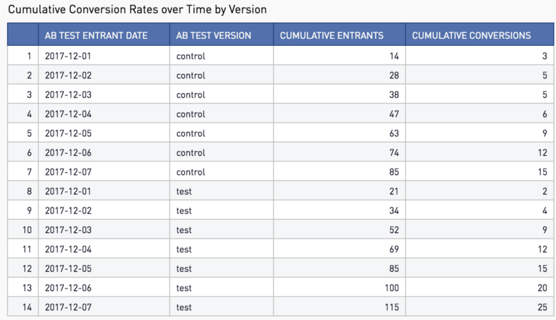

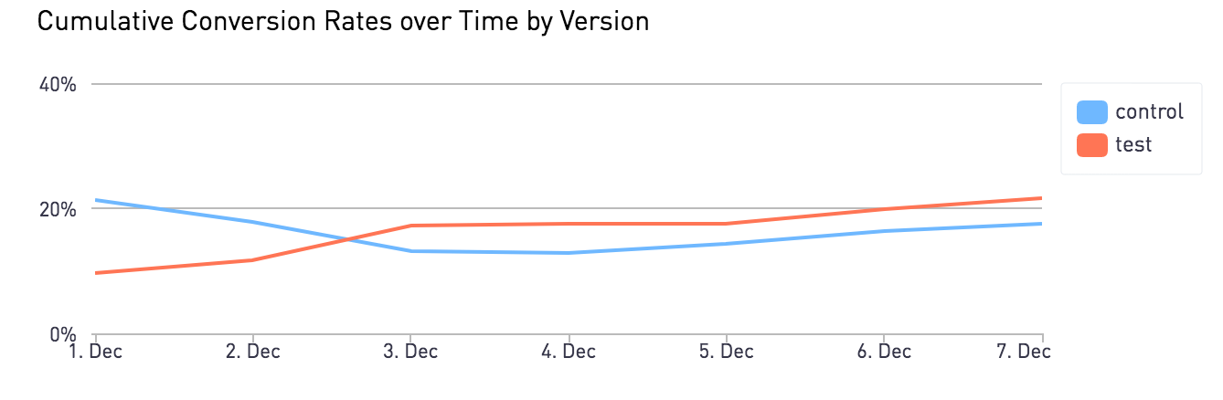

Cumulative A/B Test Conversion Rates Over Time
Another way I like to visualize the variance in these kinds of test results, is through a cumulative conversion rate over time.
with
 ab_test_conversions_over_time as (
     date(ab_test_entrant_date) as ab_test_entrant_date
     , ab_test_version
     [ab_test_entrants]
   group by
     1
     , 2
 , ab_test_conversions_cumulative as (
     , ab_test_version
     , sum(ab_test_entrants) over(partition by ab_test_version order by ab_test_entrant_date rows unbounded preceding) as cumulative_entrants
     , sum(ab_test_conversions) over(partition by ab_test_version order by ab_test_entrant_date rows unbounded preceding) as cumulative_conversions
 , ab_test_version
 , cumulative_conversions::float / cumulative_entrants as cumulative_conversion_rate
So starting from the same data set, but this time also grouping by date of entry, we can see how each day’s results affect the final outcome. Because tests like these tend to vary with different winners on different days, I prefer to track to cumulative outcome rather than daily conversion rate. It’s more clear which variant is trending towards winning, and easier to see noise and variance as well.
The intermediary CTE ab_test_conversions_cumulative looks like this:
So you can already tell that the Test variant gets a slower start out of the gate, but quickly caught up and overtook the control variant. If you take the final step in the query and divide cumulative_conversions into cumulative_entrants, you get this nice looking graph:
The most variant tests tend to cross over in cumulative results quite often. If instead you launch a test with a clear winner, it might take off early and never cross back over.
A subtle nuance to look out for here, is that by grouping by the entry date, but conversion dates can be much later, earlier dates on this graph can end up re-stated if more conversions appear. I don’t mind looking at charts that vary in the past, but for those less comfortable with that, there are ways to modify. My favorite of which is applying a “time-limit” to your numerator, so that instead of tabulating all conversions, you instead only consider conversions that happened within 7 days of their entry. That necessitates you wait at least 7 days before judging results to be final, but that delay can sometimes be a helpful bit of friction. Imagine if we had called this particular example test within 2 days, we would have thought it was a failure!
